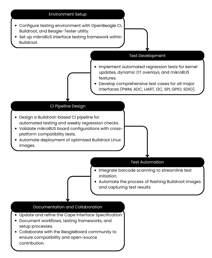

Beagle-Tester is a test automation framework designed for BeagleBoard devices, allowing hardware validation across multiple boards. This project aims to enhance Beagle-Tester by incorporating mikroBUS support and updating it for mainline kernel testing. The goal is to create an automated regression test suite for Linux kernel and device-tree overlays on BeagleBoard-based hardware, enabling continuous validation in the OpenBeagle CI server.
Key objectives include:
  • Adding mikroBUS support to Beagle-Tester to validate peripherals like PWM, ADC, UART, I2C, SPI, GPIO, and interrupts.
  • Integrating automated power cycling and remote control capabilities for test farms with multiple boards.
  • Building a web interface for monitoring and managing test results efficiently.
  • Optimizing Beagle-Tester for Buildroot to streamline deployment.
Flowchart of objectives
Figure 1: Flowchart of objectives (The following does not represent the implementation steps of the project, for that refer milestones.)#

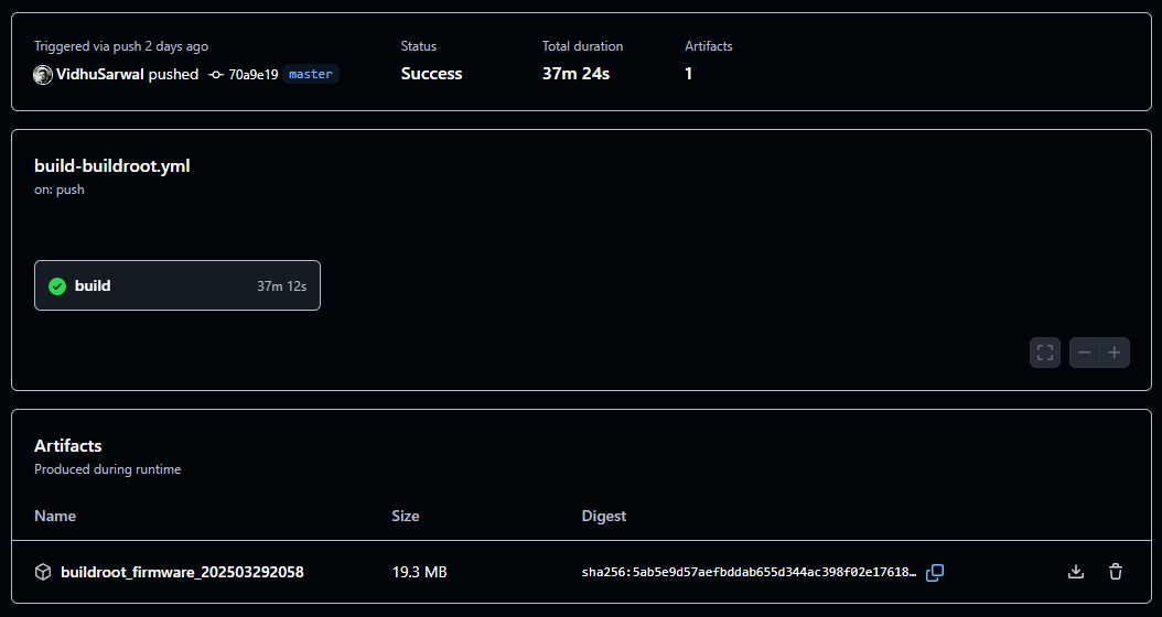

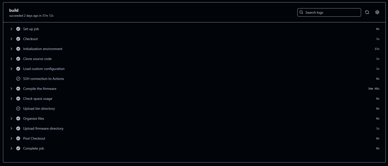

As discussed during application period, I have implemented a Github actions script demo which generates Buildroot image whenever a new push is made to .config file. This can also be edited to generate images every week for weekly regression test. The demo can be found here Link to Git I am attaching a screenshot of the pipeline as well here.
Representation of Pipeline stages.
Figure: Representation of Pipeline stages.#
Representation of Demo. The image is provided in the artifact.
Figure: Representation of Demo. The image is provided in the artifact.#

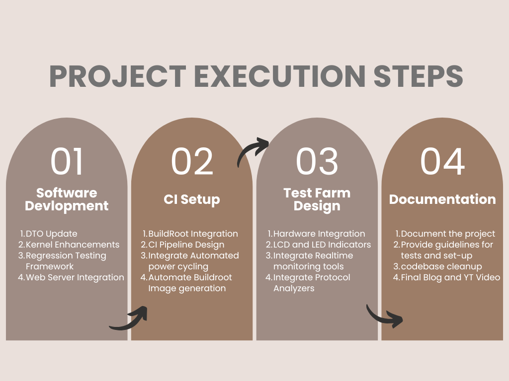

The project will be broadly divided into 4 parts as mentioned below in the Flowchart.
Process Flow
Figure 2: Representation of steps to complete project. Checkout the table below for exact timeline)#
